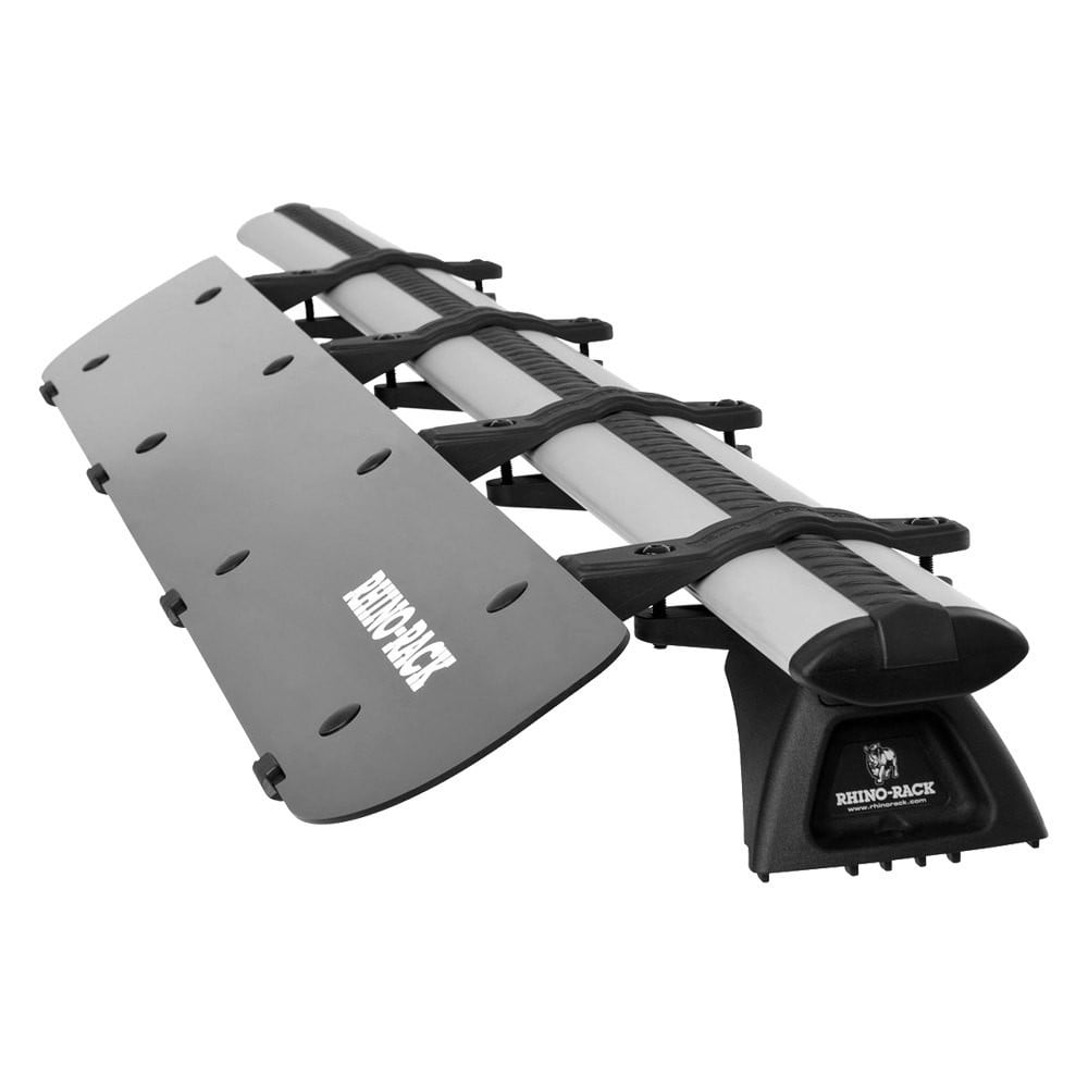

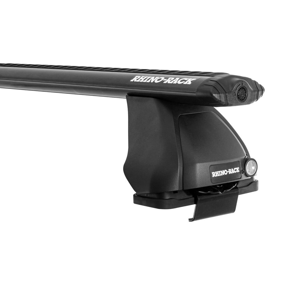

There was so much howling and sound from the GFC camper install I was worried about it long term.
I got a rhino rack bar with cowling and it resolved all my wind/howling issues. Well worth the money.
You can order only one bar at a time from carId

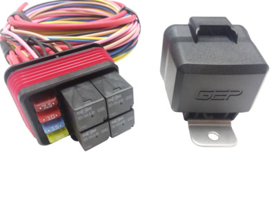

Also, next up is adding a few lights.
I'm going to wire in this relay/fuse box to make installations cleaner.
