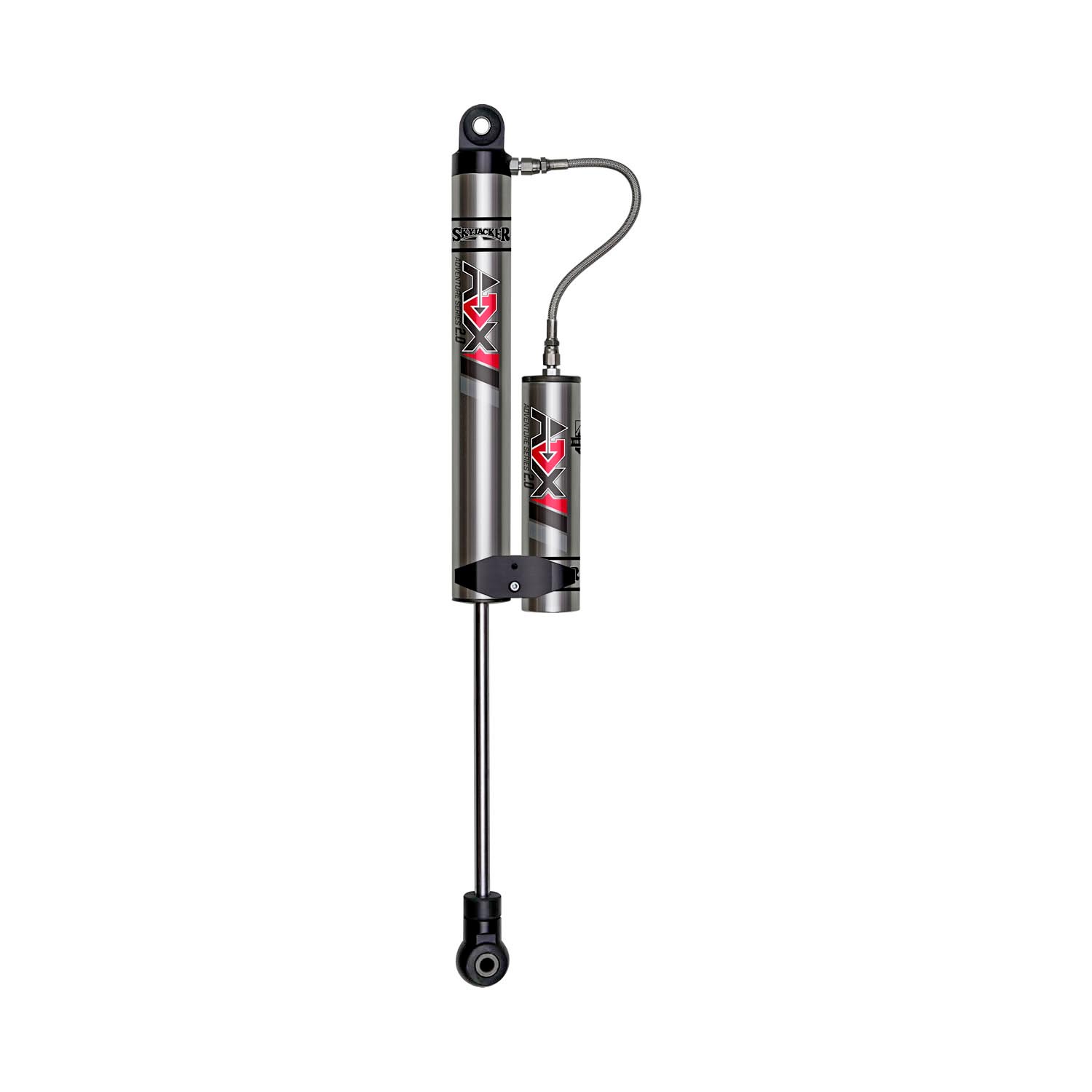

Falcon sport tow/haul piggybacks are in a good range for Tremors. 30” extended 18.2” collapsed
After talking to Fox decided to go with these:
30.45” extended 18.35” collapsed
He said I can replace the bottom eyelet or 1/4” extra bump stop if I’m concerned about bottoming out but he didn’t believe they would with the .20” bottom out bumper.

Eager to hear what you think. Specifically I like the stock Tremor's soft ride...but its a bit too uncontrolled and floaty. Especially with any significant weight in the bed. It would be great if these tightened it up a bit but maintained the ride comfort. Also would be nice if Fox officially noted this combo as compatible for the F150 Tremor.
