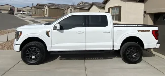

I just got a pair of these from my wife for Christmas . I installed the fox Snap rings January 2023. Very happy with the Fox Snap rings, no complaints what so ever.. I also will be putting a Timken 1/2” bump stop spacer when these go on tomorrow.

I just got a pair of these from my wife for Christmas . I installed the fox Snap rings January 2023. Very happy with the Fox Snap rings, no complaints what so ever.. I also will be putting a Timken 1/2” bump stop spacer when these go on tomorrow. View attachment 25451
Very nice! Let me know how you like them. Not sure if you're running rear wheel well guards but I'm guessing those might have to be trimmed a little. Have any pics of your truck with the snap rings on it. I know a couple of other guys have, but always good to see ONE more on level ground from the side. Or a front 3/4 angle.
I am running husky wheel well liners. Here’s a pic of the passenger side. I could have done a better job on trimming them. I haven’t had a chance to take a long drive on them to report likes/dislikes. Just installed on Monday and been working since to make sure I can continue to afford my Tremor addiction. I didn’t set the snap ring to its highest setting wanted to keep from over stressing the CV angles. Will eventually upgrade tires as well.
