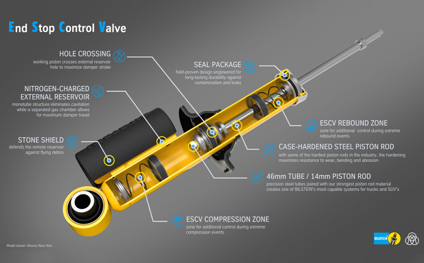

I was under the impression that Bilstein offers 90% of the performance of the big names (king, fox..) for half or a third of the cost. From my online reading, the true worthwhile investment in this game is the 8112 but that’s not an option unfortunately.
Can I expect at least as good of a performance or better (high speed offroad) with the 6112 / 5165 combo than on my Bronco Sasquatch with the stock Bilstein? Stock Bilsteins on the Bronco are similar to 5160 (piston size and external resy) but with ESCV so it’s a better tech. See picture. They let me drive without too much body roll and at 70 mph over potholes, small whoops and washboard. Loaded with gear I bottom out easy on woops at above 30mph though and wouldn’t mind a bit more performance on the Tremor.
@Yeti, I think your wife has a Bronco and if that Bronco has the Bilstein you might tell me how they compare with the Bilstein setup on the F-150
She does. They are different but definitely similar in that they are a low cost digressive shock. For the bronco, it's all about the less compliant springs. For Mountain Yak (and the lack of springs) make it pretty nice. I'm not sure I'll move away from my 5165s long term other than replacing them from some damage I caused on my last trip.
If Bilstein offered the 8112 for us, I would be on that like a fat kid on an ice cream cone. I miss the thunk.
