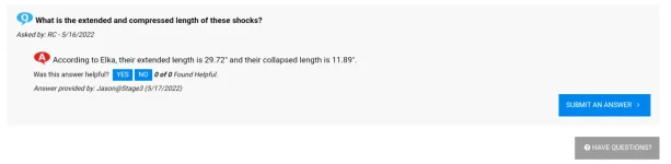

Elka 90035
29.72" extended
11.89" collapsed

"Jason@stage3" is not reliable at all 😆 Photo for product looks wrong too, that sku is just 2.5 w/reservoir & compression adjusters. Black body is for F250 suspension on Elka website.

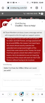

I just sent a message to two other companies that carry the 5165's that match almost exactly the proper dimensions of the stock shock to see if I could get any info from them, Bilstein still has not responded, if I can get the tomorrow I will try and call them.
This is the message

You would think these companies wouldn’t treat this sort of info like a damn trade secret
Funny enough, I think it was my call with Ivon that they said it was IP. I asked him to repeat it because it seems knowing your shock lengths are simple math problems that you need yo know before you attempt to swap parts.
