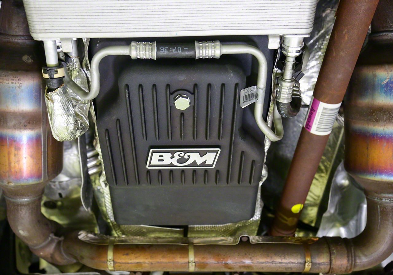

Can you share more details on the BM deep tranny pan?
With no sarcasm, what do you want to know? Deep tranny pans hold more fluid and cool more efficiently, that's about it. Same as aftermarket diff covers.

Have a link? Or is BM the company name I can google? Did you buy & bring to your service company? How many more quarts does it take to fill up?

2 quarts more. B&M is a known name in the world of differential covers, tranny pans, etc. PE is another option, really just personal preference.
I was going to do the tranny service anyways because I've read online that it should be done at 30k on 10r80s (plus I've had the tune for 20k miles and decided to do the deeper pan while they were doing the service. You can do it yourself if you have the time, if you have a lift or jackstands it's about 4 or 5 hours, mostly because of access to the pan. Can reuse existing gasket if you're careful but why not just buy a new gasket and filter at that point in my opinion, that's what I had them do.
I live near a shop that does only Ford's (Ecoboost and coyotes), and they have seen the same issue on 5 other 10r80s getting tranny services at 30-40k and the fluid coming out filthy. I'm going to do the differential fluids next, I don't trust any of the factory fills from when this truck was built.

Just an FYI, there is a heat exchanger bypass available now that lets you run a regular trans cooler and a thermostat bypass that lets it run cooler. You do have to enter the transmission for the thermostat bypass. A few options if you’re having heating issues.
And no aftermarket diff cover improves cooling or efficiency over a stock cover but the Banks cover. Gale did a long video series with tons of research, it’s worth a watch. I installed the Ford Performance cover just because it kept the same internal shape and kept it at the factory fill levels. If Banks comes out with one for our trucks I’m on it.
