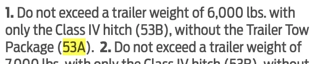

Looking through the order guide- without the tow package, it says you're limited to 6000 pounds. Also, it looks like pro back up assist isn't there? Anyone confirm? My 402A trailer package is listed as 53A. Also, all tremors get the 9.75" gearset.

Zimm we have discussed and discussed this and to be honest it's hard to say, for most of what we could find, search in here, pretty much the only info we keep getting is all Tremors can tow 10,900 lbs. Ford doesn't give a clear answer.
