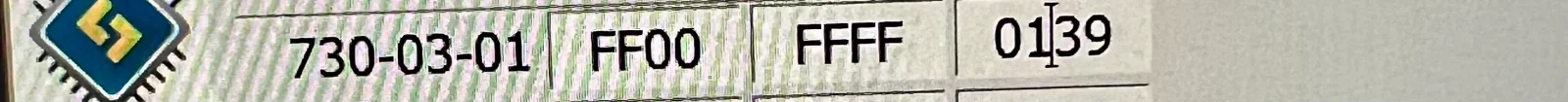

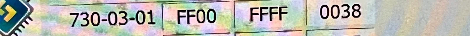

Just want to confirm this is the Auto Start/Stop disable for a 2024. Ive seen some saying its not working.
PSCM 730-03-01 xxxx xxxx 00
I made the change and notice it changed the last number on its own. Is this normal?
Before change it was FF00 FFFF 0139
After changing the 1 to a 0, cycling and reconnecting it was FF00 FFFF 0038
And this change did not work. S/S still working ☹️
