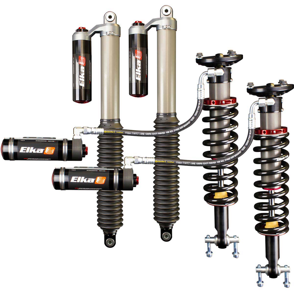

I'm interested in this kit too. I know Elka is a big name in the Toyota world and they make some quality parts.
Their rear shocks match up pretty well for our trucks too from what it looks like.

On another note back when it was F150 lifts they used Eibach springs and Bilstein shocks, they either due to better product, pricing, or supply switched to using Elka produced parts.
They are completely rebuildable, and I think if you order from them and decide the spring is rated too heavy for your liking, you can request a lighter spring weight. However if you're increasing tire size etc, the heavier weighted spring would help, along with adding a winch you would definitely need a heavier spring than comes with most others. So these should be superior than most, I just wished they were adjustable for rebound/damping.
To add to what he said above, I would guess they have done the same thing RC did, which is take an existing shock and ensure it works.
I want to say Elka has adjustable cans available
