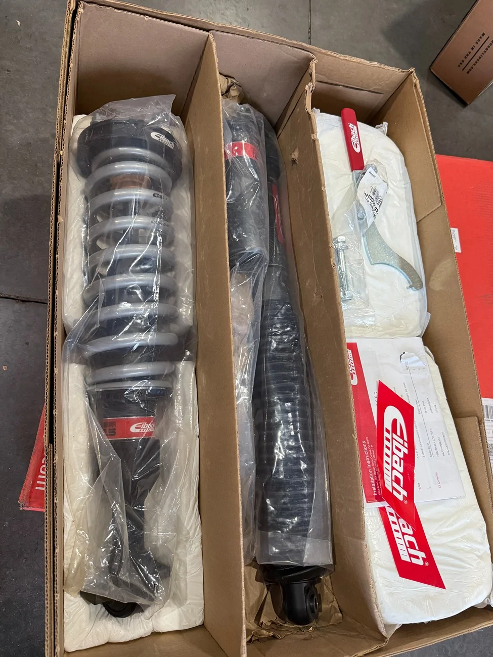

Snagged this from another forum: posted yesterday: I am not affiliated. just forwarding the info in case people are looking for 3R kits that are in stock.
hotshotoffroad.com
We have received our second round of 3R kits and have kits on the shelf ready to ship! We cant thank you all enough for the support and patience from our first round of orders. We have fulfilled every out standing order we had from the first run and just had more kits hit our doors today. Come and grab your kit while you can!
We are also doing an Hotshot Offroad exclusive promo. Order any Eibach 3R kits and you can receive a FREE Cam Nut with your purchsae. Just add both products to cart and your cam kit will discount off for FREE. Act fast, we are only limiting this promo to the next 5 orders that come through!
Plus we are doing Free shipping on kits AND no sales tax on orders (AZ excluded)
Hit the links below to grab your kit and if you have any questions as always please let us know!
Eibach 3R kits: https://hotshotoffroad.com/collecti...cts/pro-truck-stage-3r-coilover-kit-2021-f150
Cam Nut Kits: https://hotshotoffroad.com/products/adjustable-cam-nut-bracket-kit-04-f150
Ford F-150 Our Eibach 3R Kit Restock has landed! // Promo Inside IMG_5291
