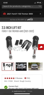

Any thoughts on the RC 2.5 level? This is what my 4x4 shop is recommending.
That is the kit that I used on mine in the pic. The shop that put it on recommended not dropping the rear end as included in the kit. I choose not to drop the back ans this is the results. It is a slight rake but not noticeable. Afterwards I put some 295/70/18s on the stock wheels, and this is the result. I love it. Nice smooth ride.
Same. Did the RC 2.5 but did not do the lower rear blocks. Did the vertex rears. Rides great, going to fully test in NC next month.
