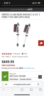

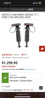

Spoke to rough country engineering today and they said the vertex coilover( 3” lift) should work in the tremors, they just haven’t tested it yet to confirm.with their 30 day satisfaction ride guarantee I’m Thinking about ordering those instead of the n3 strut kit along with the 0-3.5” rear reservoir shocks.. any thoughts?
