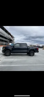

I haven’t seen anyone post information about the Ford Fox 2.0. I just purchase the Tremor and the dealership put on the Fox. Truck rides better and it lifted the front at least 2”. See pictu

I believe it was a pretty simple process. The dealership installed them in a couple hours. I verified the installation did not void the warranty. That’s why I was surprised I haven’t seen more about the Fox 2.0 Ford performance on this forum. I will add pick of the shocks

I haven’t seen anyone post information about the Ford Fox 2.0. I just purchase the Tremor and the dealership put on the Fox. Truck rides better and it lifted the front at least 2”. See pictures
Can you provide a side view pic on level ground? I’d love to see the stance.

It has Ford performance on the shocks. I did test drive before and it feels better to me. I really liked the ride before the fox shock, but with the fox I feel a little less body roll and the rear really absorbs the bumps.

I live in Idaho and I know several Ford dealerships are using the Fox on the new Tremors. I definitely have 2’’ of lift in the front. I hope the dealer is installing them properly. They do a lot of lifts and after market products and feel they know what they are doing. I was also interested if anyone else in this forum has installed them at a Ford dealership
