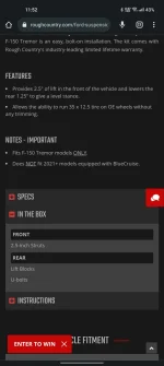

I know it hasn't been talked about in a while but can anyone with the ROUGH Country strut kit confirm if the cv boot is at risk of rubbing when at full droop?
Also why would it not work with a truck that has blue cruise?

I believe the cameras need to be recalibrated from the increased height but we will see. I have blue cruise but haven't tried it yet, I will give it a shot after my 2 inch leveling kit is installed and report back.

I work with ADAS at Blue oval and can tell you that you might need calibration done. Most the time the dealer can do this with the FDRS tool and calibration doesn't need to be done unless the ride heights that are input into the ADAS module are within the range of the new set up. If new set up is more than what the old ride heights were then someone will need to input the new ride heights and run calibration.
