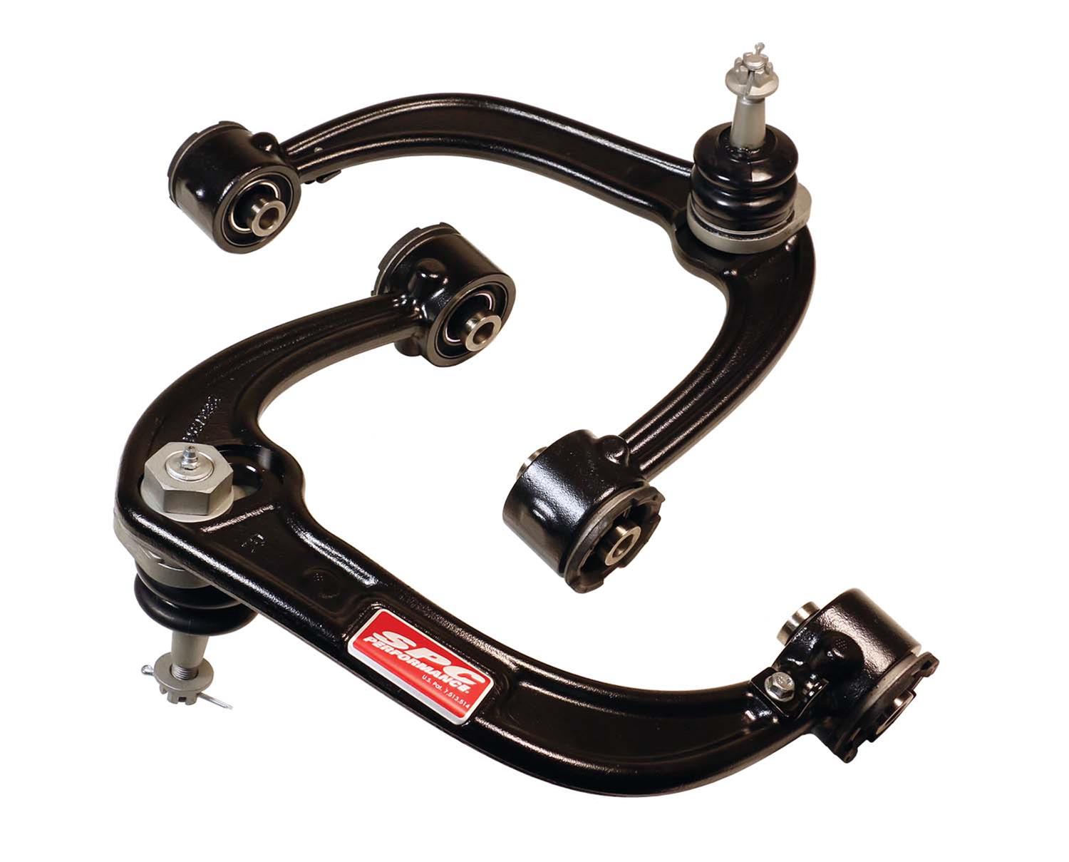

For the UCAs (SPC, 25685) ($799) front coils from RC (51028)($409), vertex rears (699012)($899), provide, install, align, tax was $2950. (3.5 hrs labor @ $140/hr)
I didn't know the spcs for 21+ were out in the wild, yet.
