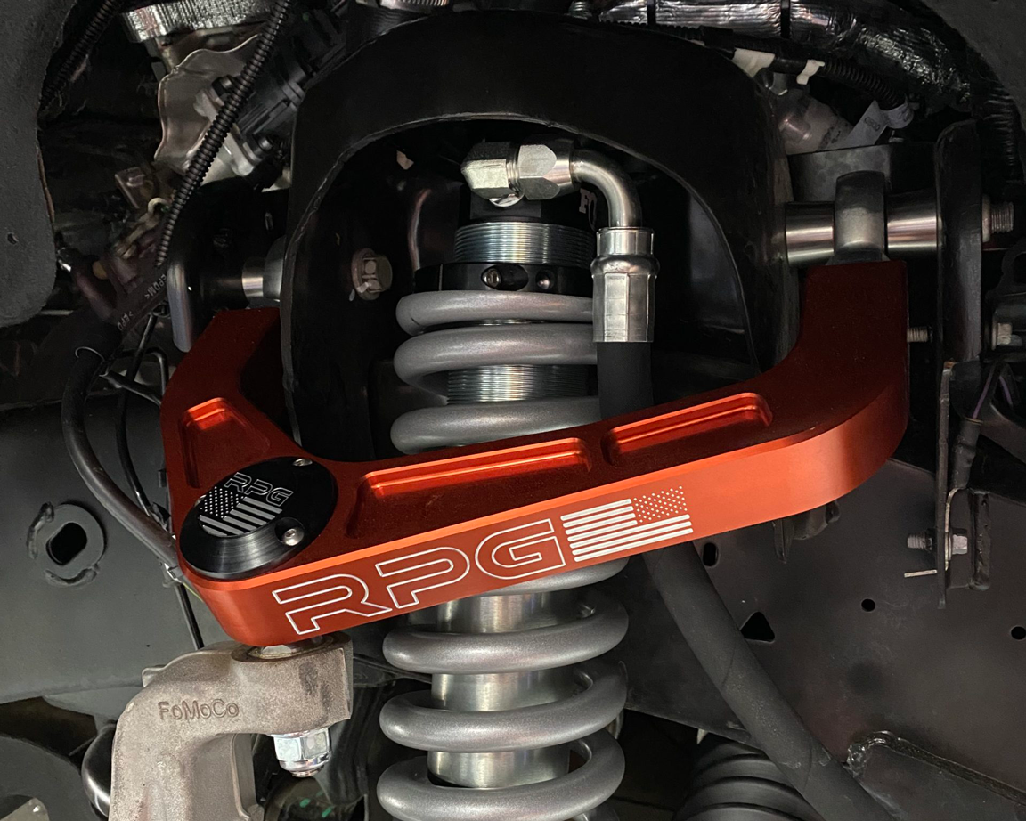

Why not billet? It's stronger!

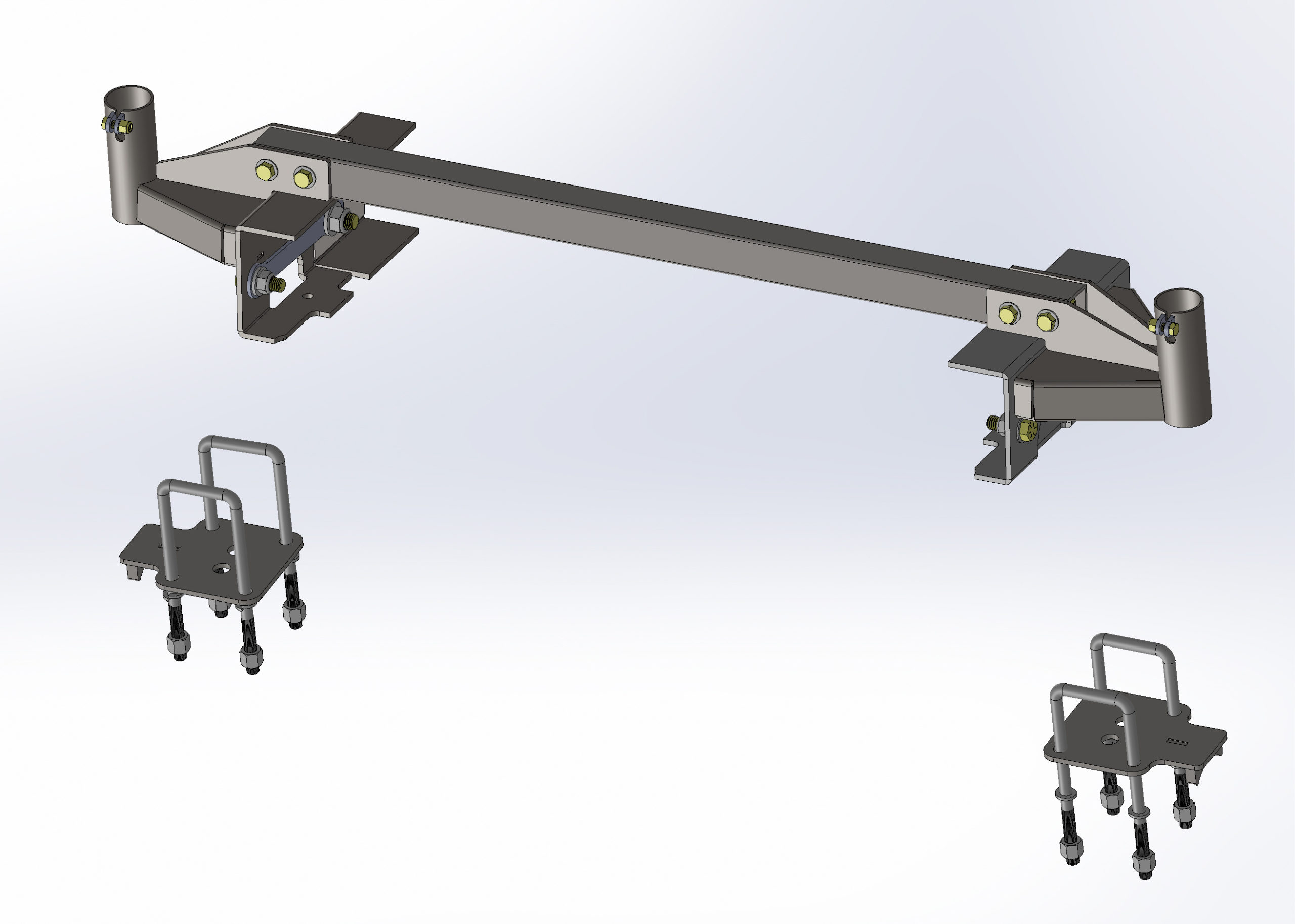

And you can do so much more...

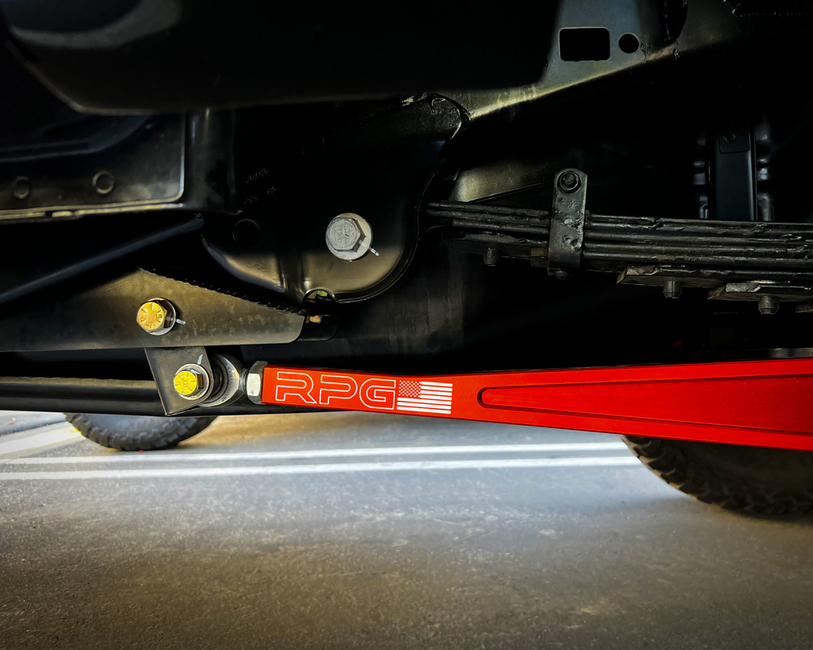

Or start small and work up...

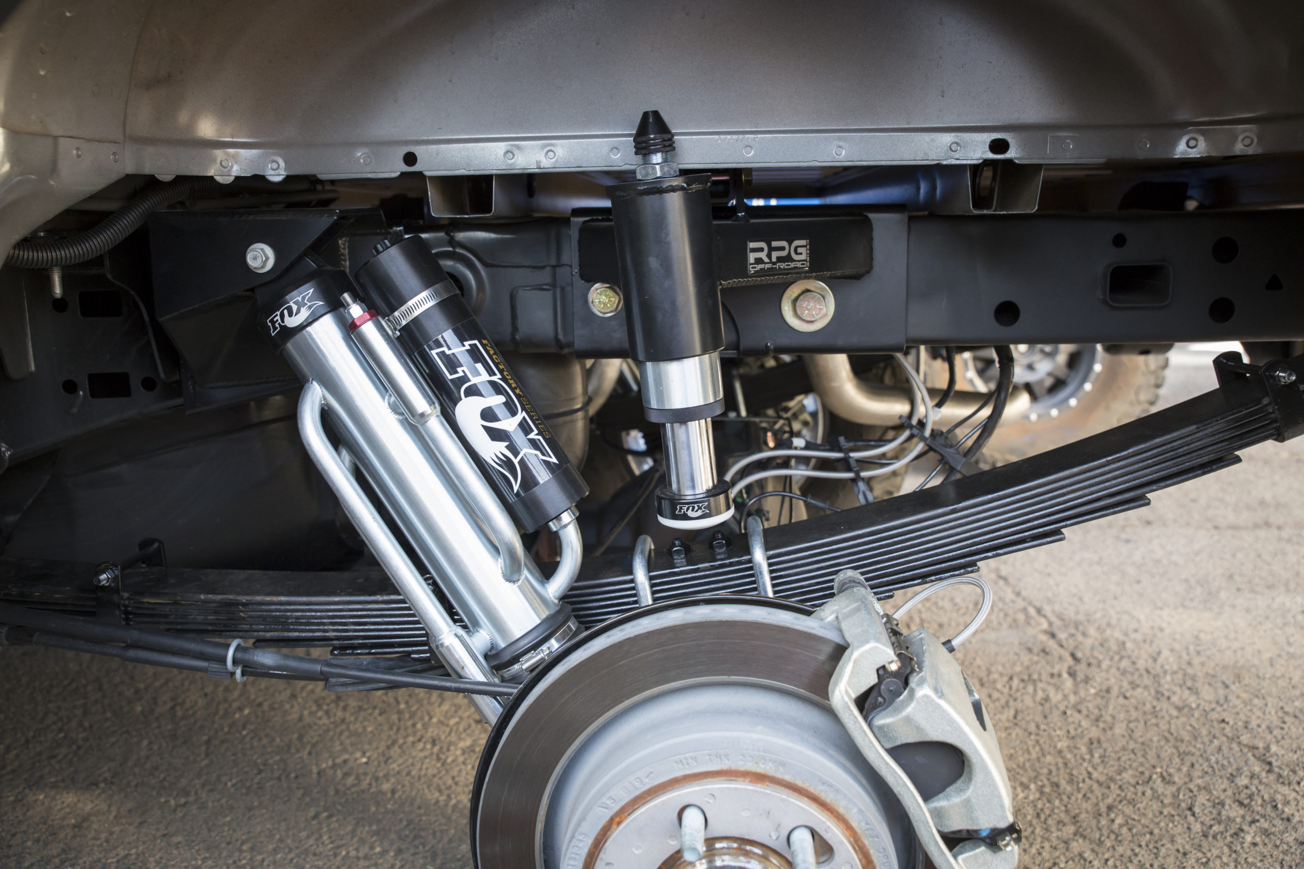

Plus random things that, let's be honest, we all need....
And this is just RPG! There's so many other brands to decide from. Don't limit yourself! You deserve better, and so does your truck.
