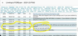

I just went with the setting noted in the spreadsheet and it worked fine. They're effing bright and don't flicker. I had a trucker get pissed the other day claiming I had my high beams on when I overtook from his driver's side.

I kept getting an error on the code. Did you go with the 100% on the lights? Or a different level?
No. Look at the spreadsheet. It says to set between 60% and 75% using the LOWEST value you can before flickering appears, then gives you the hex value. I used the 60% hex value and it took and does not flicker. Be sure you also use the line above it.
I went with the value for 60%.
BCM 726-38-01 xxxx **xx xx--
3C (60%) << I started at lowest and was happy >>
41 (65%)
46 (70% )
4B (75% )
