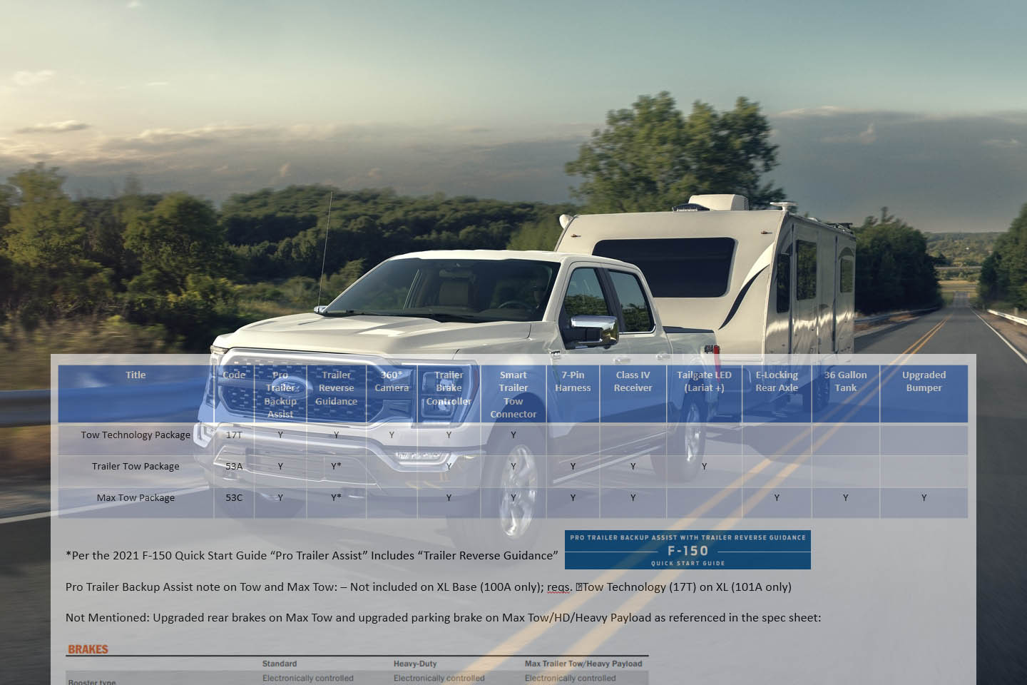

Here's that thing I mentioned, courtesy of @Troy. Clearly a different set of specs for Trailer Tow class (whatever that means). This piece of literature doesn't specify a package...and I don't know what CICAE, CICAP, or CICAQ mean either.
On this doc, interesting that the cooling capacity is the same, the fans are the same, the width is the same. You're getting 3 more millimeters in height (about 1/8"), 2 mm in core thickness (a little more than 1/16") and about 10-15% more tubes and fins in that radiator.
@Troy, @Coachdad and @High_Country - We have found documentation showing that you get a bigger radiator with the trailer tow package.

I've never been able to find the radiator spec on the ford's site, so I can't really confirm if it applies or not. But its certainly compelling. But then again Ford has conflicting info. If it was clear in even most places that you need the 53A no problem, but multiple official documentation says you don't. So I'm still at I have no idea, take your pick. Given that Ford allows you to buy you'd assume you get something. But If I'm dropping a grand on something I want to know what the heck I'm buying. So either way shame on Ford.
