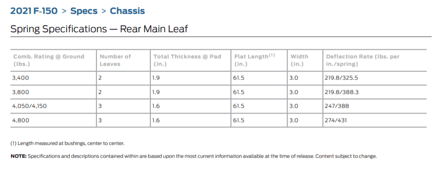

I also have the Tow Tech package on the 402A and 3 leaf springs. Honestly don't think there are any differences.
But which 3 leaf springs do you have?

If true then none of the Tremors must come with standard 2021 F150 leaf spring which is the single leaf+composite leaf (I actually want this lighter spring/rate). Perhaps Tow Pkg adds stronger axle like the max tow.
Remembering there are two different 3 leaf springs for our trucks, that would make absolute sense.
