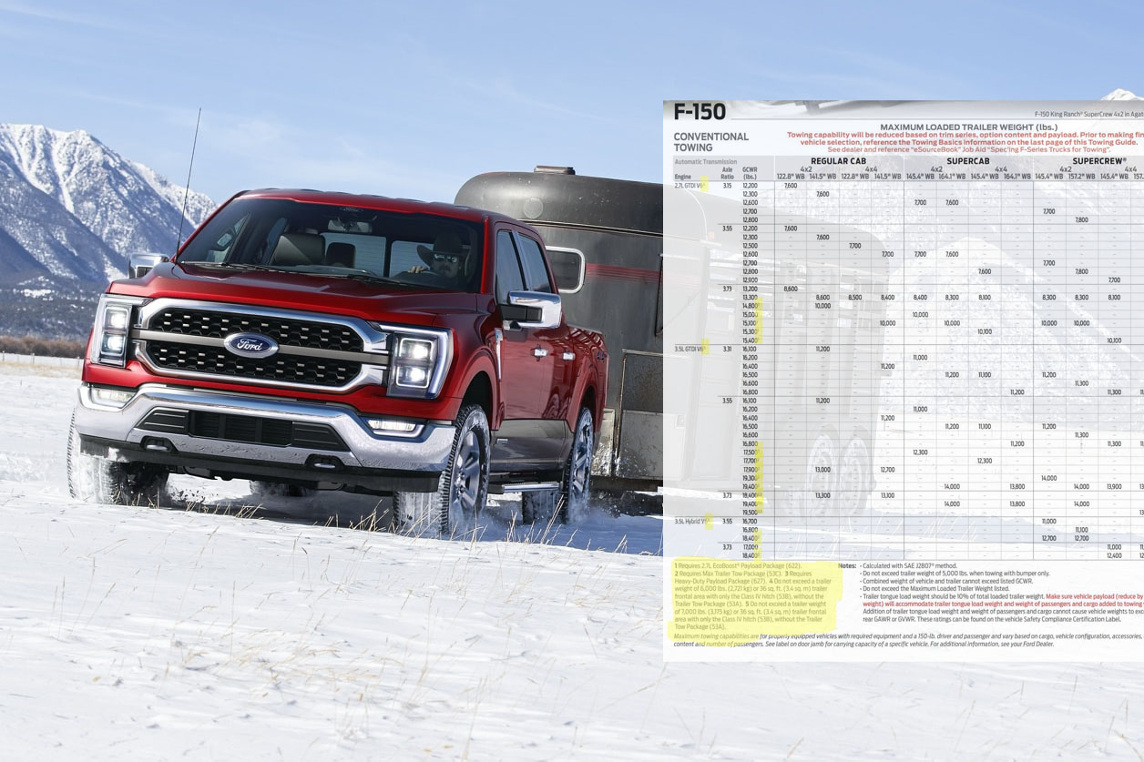

Was reviewing Ford's trailer towing guide here:
It's interesting to note this chart:
Package 17T is the Tow Technology Package and 53A is the Trailer Tow package. In the note at the top - all three packages (17A, 53A, 53B) are listed as a "Trailer Tow Package" though. 53B is the Class IV trailer hitch by the way. In this chart, the Tow Tech package (17T) gets you everything the Trailer Tow package (53A) does except a hitch receiver and 4-7 pin connector...but those come standard on the Tremor anyways.
Here's another chart from the same document:
Again, they list all four packages together as "Trailer Tow Packages".
So if we go back to the one chart from earlier....
...maybe there's some weird semantics in the 'with only the class IV hitch...without the Trailer Tow Package (53A)'. I wonder if a guy had the Class IV hitch (we all do) plus one of the other 3 packages listed in this document as a Trailer Towing package, this note wouldn't apply.
Also interesting to note this is all with a 150lb driver. How many of y'all are 150 lbs?!?!? ;^)
