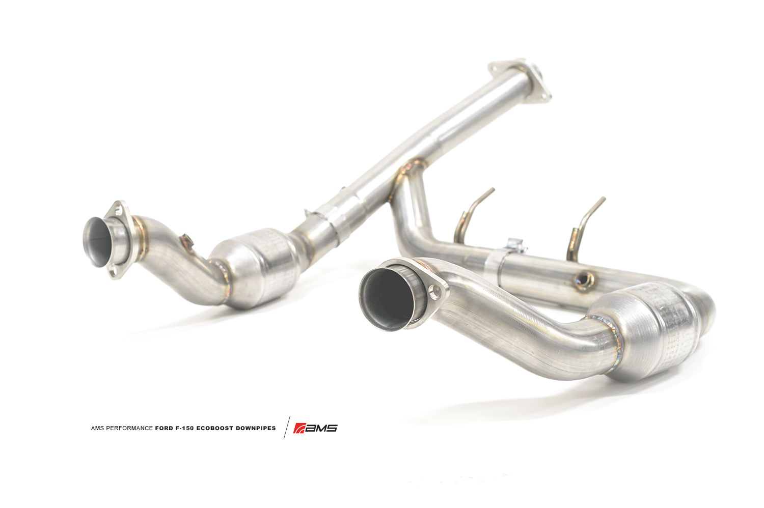

Now I just need to find some catted downpipes and figure out if supply side plumbing is worth the upgrade and I’ll hopefully have Pandora’s box emptied enough to get the lid back on.
I have glanced at catted downpipes and haven't seen much that is of interest for ours yet. I also haven't looked to see if it is different than the previous model years....so these are for 2020, but good options of they fit.
AMS is about the best you can get, and you will pay for it.
SPD is a good quality cost effective option, but doesn't provide as much flow.
