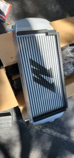

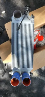

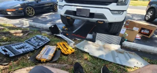

I have no idea how much it would cost, but really it's crazy easy. Like I said in the writeup, i did it without even jacking the teuck up and I put the biggest intercooler available on. Worst part really is getting it up in there. Hence the buddywife recommendation lol.
I absolutely love the pssshhhhhh everyday I drive the truck I smile more now haha. The dealership commented on it yesterday when they did my recall/5k tune up, everyone loves it.
There is not a single more important/impactful mod than an intercooler for these 3.5l imo. Don't sleep on it! You won't get but dyno results but the engine will thank you.
Awesome definition lol!
I think I'm gonna do it along with Livernois tune. Air intake, exhaust, w intercooler and that tune should be pretty awesome combo!
Why not? It's pretty simple. Mine comes in this week hopefully. Will report back. I got the mishimoto, but I found the new gen on Amazon with the drain, in silver instead of black with the M on the front like the old one.
Just read this, did you install yet? If so how did it go?
Gotcha, hope everything goes smoothly!

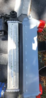

All went well. Wasn't hard as far as difficulty, just alone it's a challenge getting it up and holding it up to bolt it. The new BOV sounds great, and the intercooler looks great. It's significantly larger and heavier than the stock one, and has the drain valve.

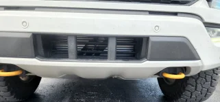

Been wanting to pull off the shutters in front of the intercooler as they seem counterproductive, and i don't like that they won't open until the truck is extra hot. They're closed a majority of the time.
I've read it could cause condensation, but my intercooler has the drain. Should be fine?
Also wondering if they're there for protection from road debris. Anyone take theirs off?

I haven't read too much into this but I was thinking about just removing mine also when I installed the intercooler. They seem to be inefficient from what I read. I was more worried about if I remove them what will happen in terms of throwing something out of whack like codes or throwing off the ECU, I guess depending on how you would disconnect or remove them. Again I did not do a lot of research on this but that was my thinking at the time of Intercooler install. I agree with the drain and should be fine. Protection may be in issue especially if you off road a lot. Wondering if that was one of the reasons Ford run them the way they do? :unsure:. Hate to damage a new intercooler. I too am curious if anybody did take those shutters off?
Here's one comment from the F-150 forum on removing the Active Grill Shutters. Rather old but....
It throws a DTC but doesn't illuminate the CEL. Removing the shutters is required for the installation of the intercooler replacements too.
That said, the shutters do benefit you from a fuel economy and a time-to-warmup perspective. You could also consider one of the more minimal grille guards/bumper replacements that allow light mounting.
This is mostly true. You don't have to remove them completely though. Just the shroud around them. I did a whole write up on page 2 of this thread that covered this too. The few guys I know who have them off, haven't had anything happen yet. The IC is obviously more susceptible to debris damage though after removing them. Just hasn't happened to the people I know.
