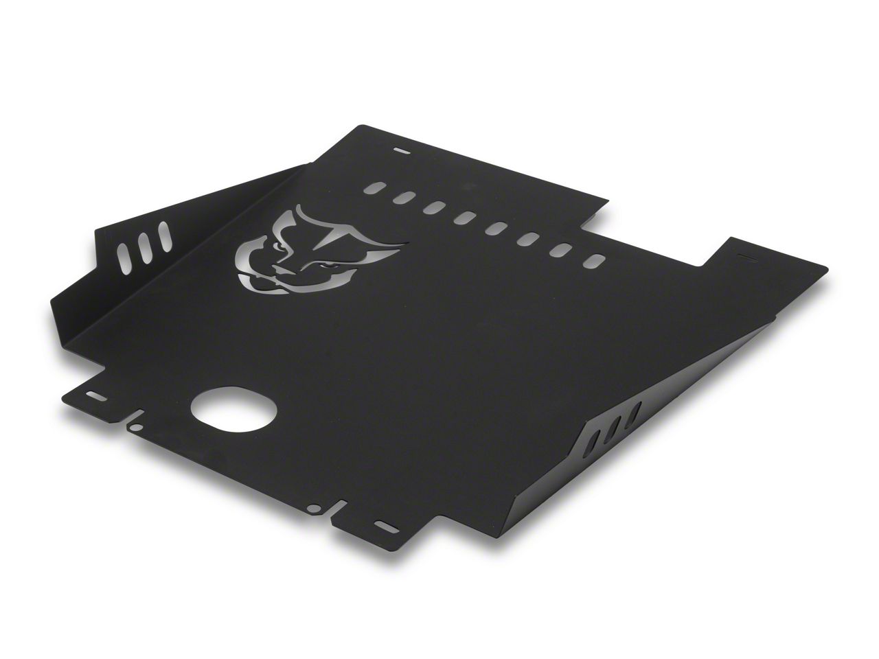

I ordered a ‘23 Tremor with V8. Do you think the raptor skid plate will fit 23 MY and will the oil access on the skid plate line up with 5.0?

Might want to wait for the 23 raptor R skid plate to be available. I imagine that one will line up for sure. If it stays the same, then you'll know your good with the current one.

It should fit the V8 as well. There are people with non tremor V8 that have installed the skid. One note is that since the V8 does not come with the cardboard cover you will need two additional bolts and clip nuts for the front of the skid plate. I reused the ones installed on the old cover, but you will not have that option.

I ordered the Raptor skid plate that was listed earlier in this threat with the 4 bolts and 4 nuts and installed it in approx 30 min today. Worked perfectly. This skid plate is a little larger than the cardboard one that came on my tremor, but it bolts up easily and fits like it’s meant too. Also, there is 6 attachment points, so I did use 2 bolts and nuts from the stock cardboard plate with no issues.
Highly recommended! It was a great solution! All in I was $220 with tax for the plate and bolts.

Has anyone done the rci skid plate w/cat protection? Mine is arriving today and wondering how much of a pita it'll be to do during a lunch break

My RCI was pre cat protection & modified by me (Somewhere back in the beginning of this thread.) but was a easy job by myself, took about 20mins if I remember correctly.
Anyone have one of these? If so, do you know the weight? Since the current cover is that flimsy felt and the mounts to hold that on are not necessarily designed for a heavy piece of metal...Just wondering is someone has put this on and had no trouble.

The Raptor plate has its own arms on the side, so you don't reuse anything from the fibersorb panel, except the bolts. The R-plate weighs 21lbs.
If you're planning on using it as a skid plate, you may want to be creative when you mount it.

Good info, do you have any pics of your install? Also, does this allow for a trouble free oil change or ?
